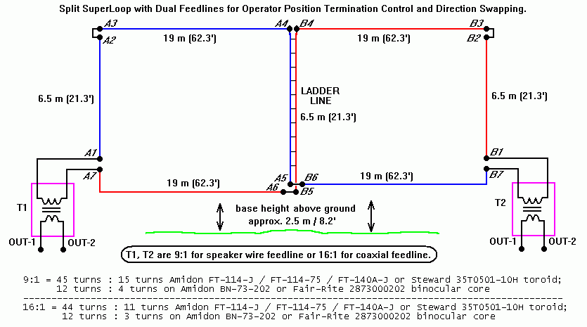

The Split Flag / Split SuperLoop designs might also be worth a look to see if reasonable gain and directivity can be mustered in a less-than-140 ft. length. The inconvenience of these typically requiring three tall supports may tend to rule them out for some.
http://www.qsl.net/wa1ion/pictures1/dual_feed_split_flag.gif
http://www.qsl.net/wa1ion/pictures1/dual_feed_split_superloop_38m_long.gif
http://www.qsl.net/wa1ion/pictures1/split_superloop_201709.gif
